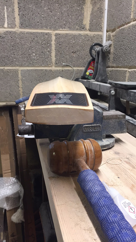

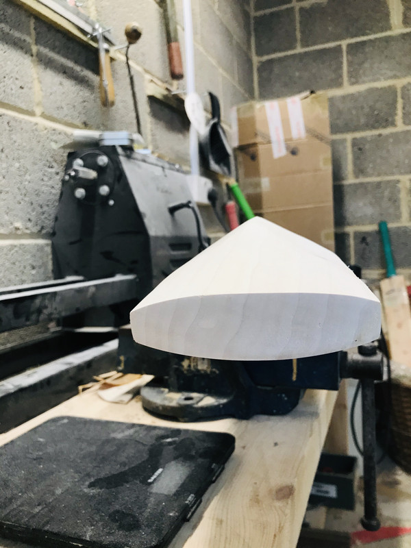

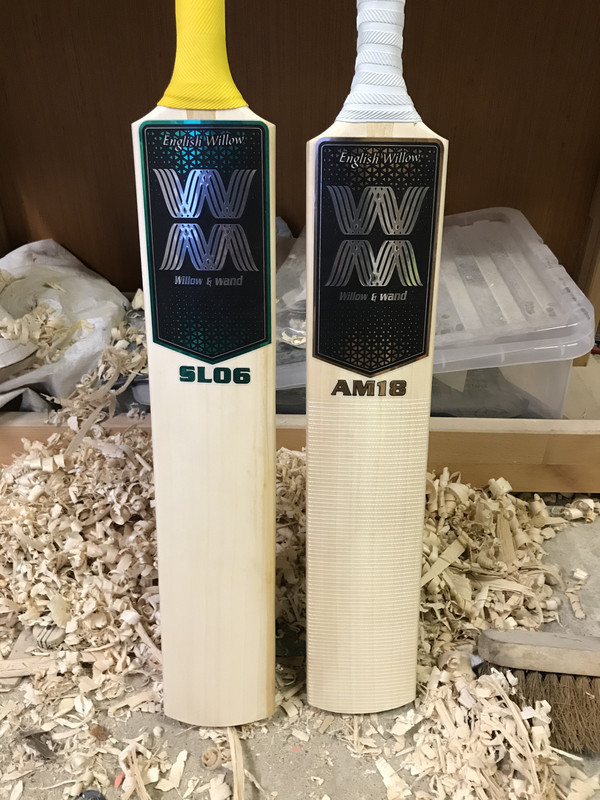

Most recent piece of willow to be commissioned is a back to old skool shape with a modern twist. This is a classic version of my AM18
Edges 24mm
Toe edge 18mm. Toe centre 24mm
Shoulder 16mm
Low profile swell

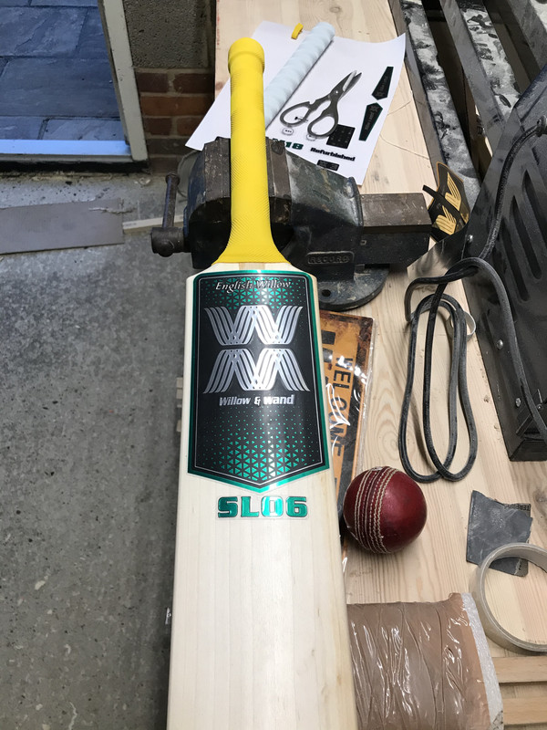

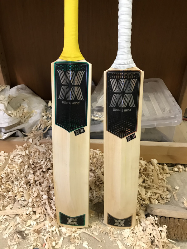

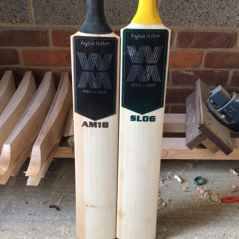

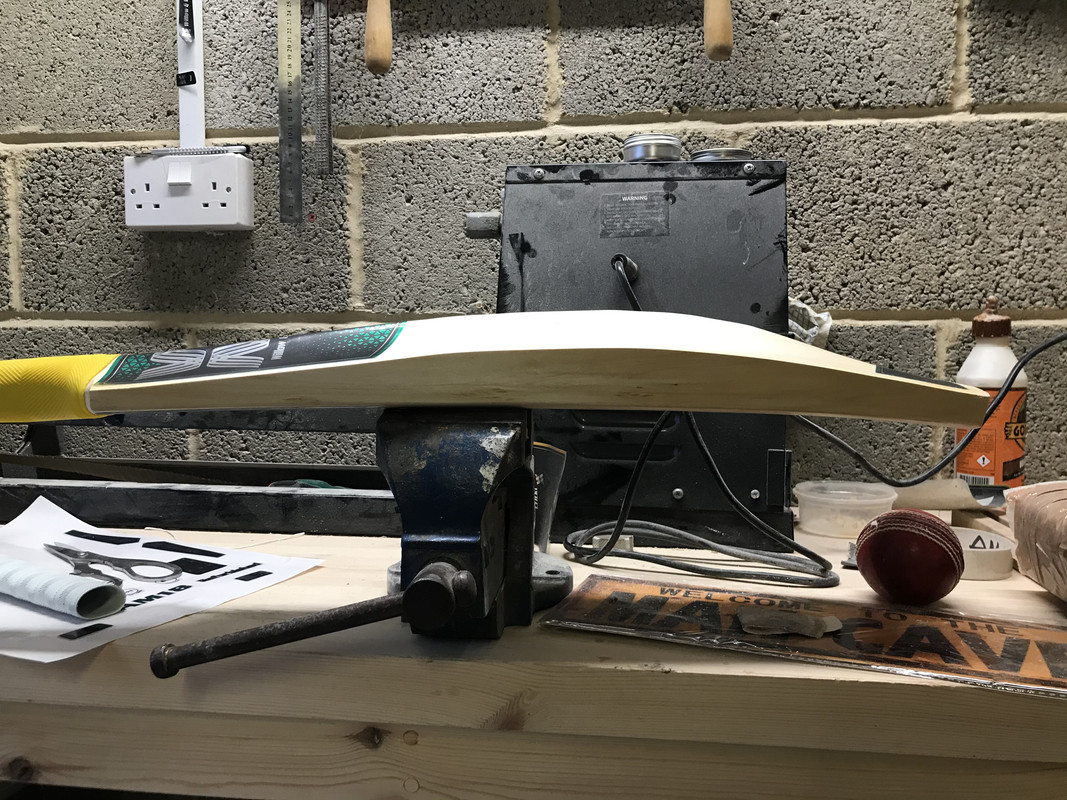

New stickers have arrived and must say really impressed and they certainly make such a difference.
First new sticks to receive these are a G2 SL06 - 2.10 finished weight, 37mm edges medium concaving, double bound super thick handle as per customers request.
Second is a copy of a old Unknown and was unbranded bat - 2.8 finished weight 23mm edges and totally full shape.

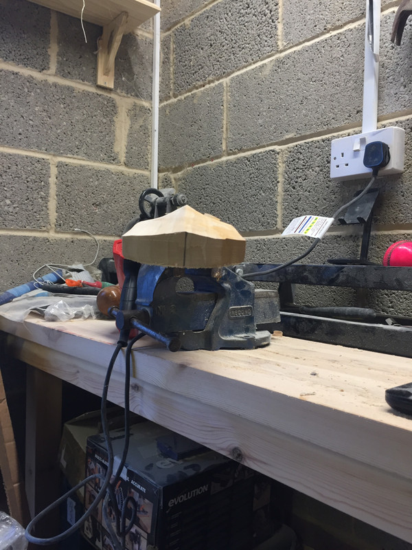

So May has continued to be a very busy month with these 3 made up over the last couple of weeks.
These two are off to someone on here, both spine into toe shape light at 2.9 or a little under, 35mm edges on one and 36mm on the other. Both grade 2 and light concaving to keep weight down. Like making the spine into toe shape as it’s a bit more or a challenge.

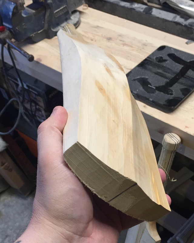

The third was shaped from a cleft that had a large chunk removed from the rear of the bat during machining so I made a traditional edge, high spine full profile. I based it on the M&H distinction. Weight is 2.10 finished and it’s a G3 with a half heartwood blade.

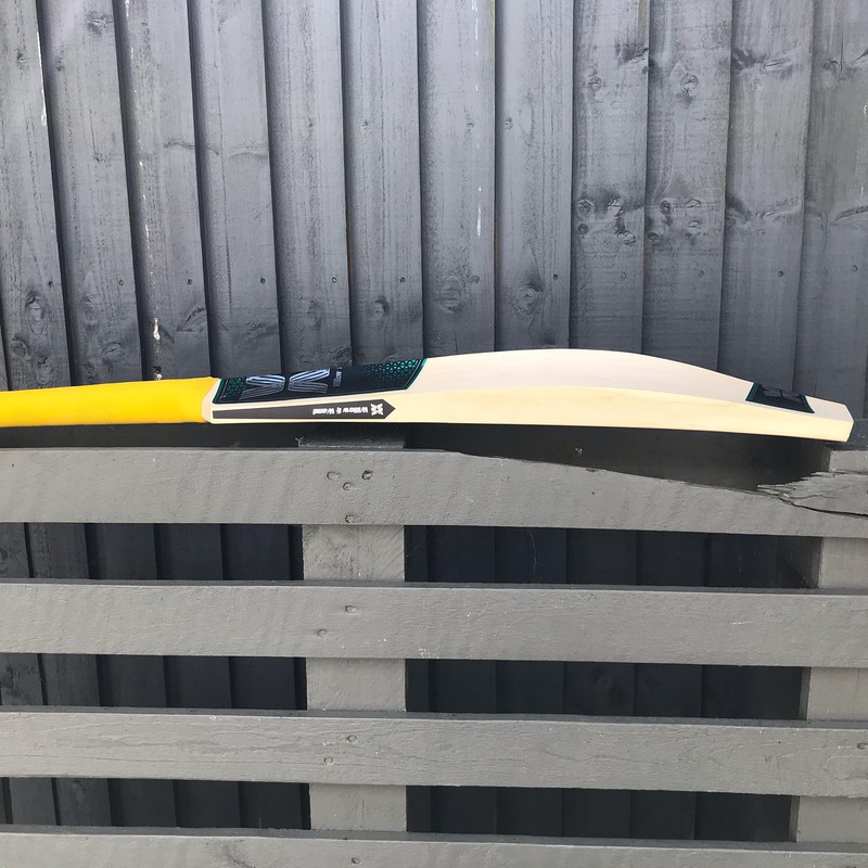

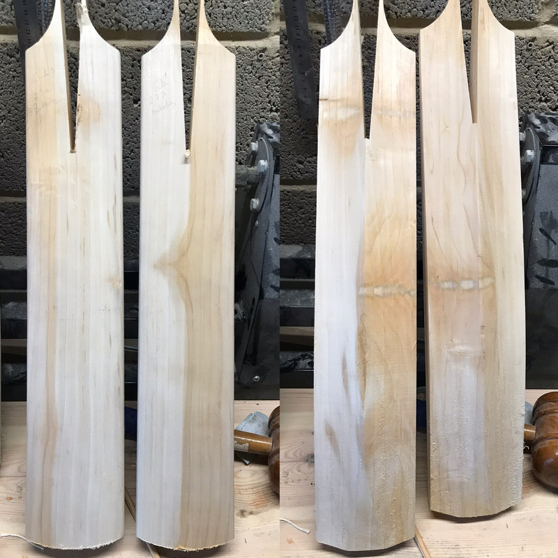

Little upload on the last week or so’s work.
Lovely size 5 G1 SL06 shaped up and off to local lad. I know my first English Willow bat wasn’t anything as nice as this back in the early 90’s.

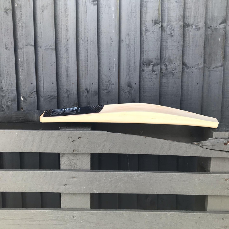

Finished off this pair of stunners in both my stock shapes but with slight twists of spine into toe as opposed to the normal duckbill shaped toe.
Both nice and light at 2.9.2 and 2.9.9 fully finished with top quality thick U.K. chevron grips.
And finally had a new delivery of willow late last week and just got round to cleaning up and handling these two stunning Butterly clefts. These have lovely grains that are nice and tight and are also fairly light for Butterly so will make some decent sized bats in around the 2.10 range ideally.

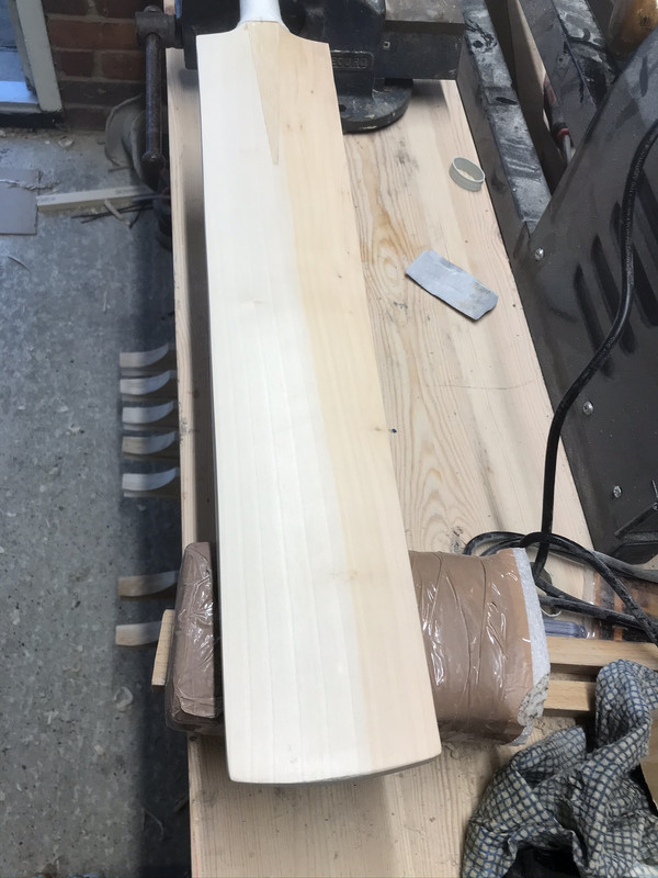

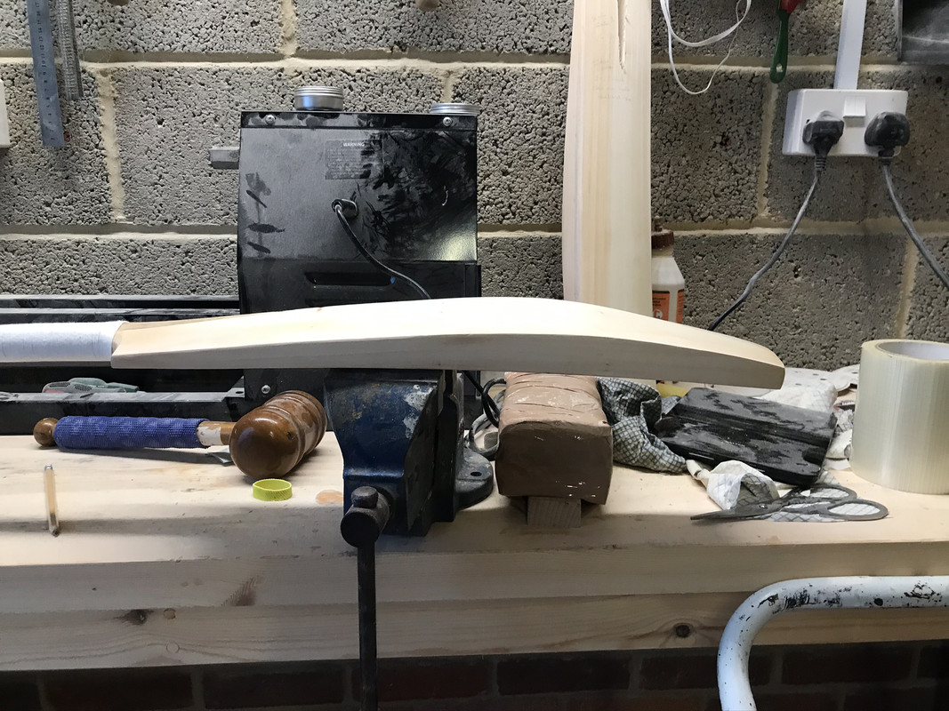

Here is the custom Butterly finished for @tommo256. Shape was based on a shape the the customer liked and asked me to copy for him. As I do for everyone pictures sent along the way at each stage to ensure customer is happy and I’m in on track to create a bat that the person really likes.
Must say iv made a few shapes now with a spine into toe and they pick up is noticeable light on all of them, this with a mid swell and thick handle is superb even if I do say so myself.
A few pics of this bat.
