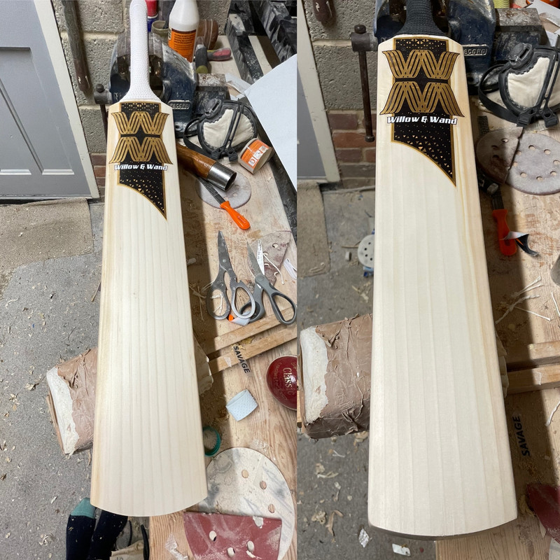

Is the willow and wand on the red only backwards for me?
Yes mate but only because I flipped the image to fit into a layout for social media
Re: Soulman’s sticks
« Reply #421 on: June 15, 2023, 11:56:38 AM »
You'll be glad to know you're not losing it 😅 suspect it will be from  the pictures being stitched together.
Like the new stickers, big improvement on the previous iteration.

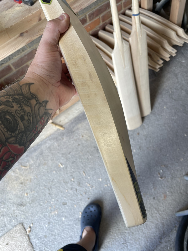

Couple of G1 bats finished for the same customer. A stock AM18 profile at 2lb 8.7 and a copy of a TON bat at 2.10. Both superb grain wise and at £329 offer pretty good value. Both finished in the new Gold and Black stickers. AM18 had 33mm edge 19mm toe at edge and 26mm at centre of toe. Ton copy has 36mm edges, 21mm at edge and 29mm at centre of toe and unlike every ton iv ever seen it’s full width lol.
AM18 on the left, copy on the right in first couple of pics
AM18 profile
Copy profile

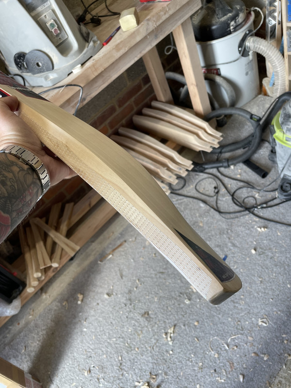

Another G1 finished off today in the SL06 profile which is a modern “players” shape with a square toe vs the AM18 with the traditional rounded toe shape. 2.10 finished weight with 33mm edges and full profile. This one has one of the sample colour sets of stickers which I didn’t release as thought they were similar to the gold. Opinions ok this colour option??

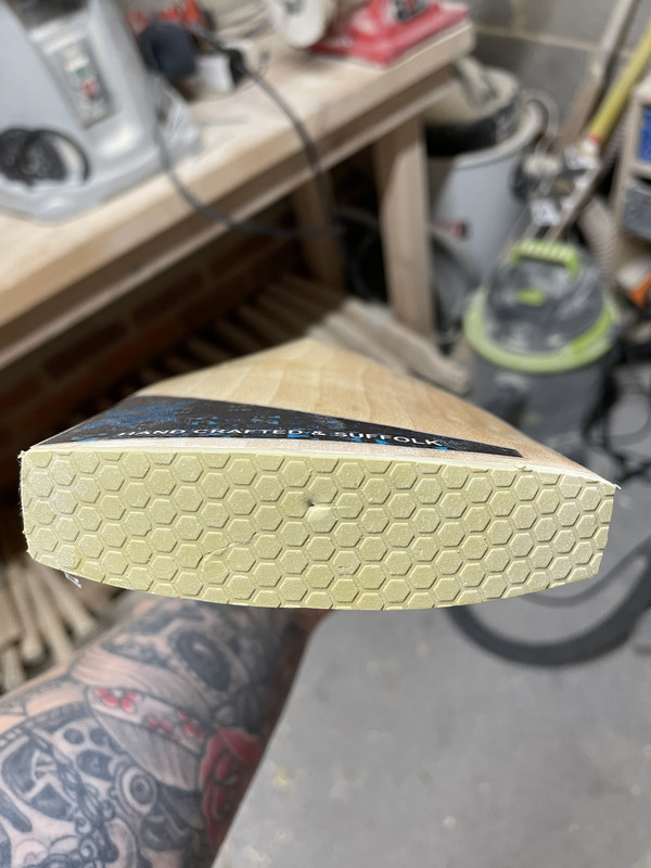

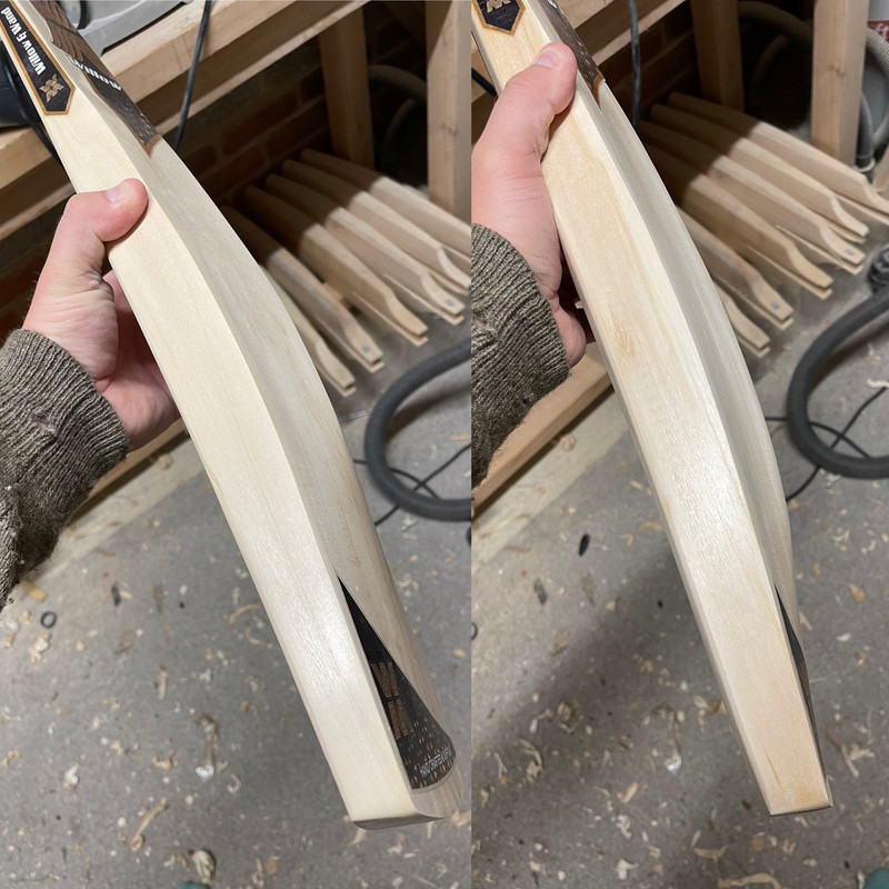

Morning all. Not shared much regarding Willow and Wand recently which if I’m honest is mainly due to the fact that engagement vs time to upload is the main reason but thought as I uploaded a few pics of the GN powerspot I’ll do a few W&W ones.
So couple of things iv been looking at since the end of the season.  Firstly new shape iv been working on for 2024 using a 1 inch shorter blade/longer handle set up. Just trying to make these as big as possible but at realistic weights.  Iv used a shorter blade set up for years and to me they do just work so much better. This has come about as a pure T20 swing it and smash it bay and will be best suited to a weight range of 2lb 12oz and above to get those 37/38mm edges, fairly full shape and 63/65mm spine.
Secondly was that with the rapidly increasing costs of all materials involved in making a bat etc iv in the last years had to move from not being able to offer a bat below the £200 mark using the G1,G2 and G3. Iv still managed just about to keep the top grade below £350 so wanted to ensure I was able to get back to offering  sub £200 handcrafted bat. So Iv managed to find a supplier and will be offering a sub £200 bat for 2024. This will be the same price as Butterly and the range will be G4 and Butterfly clefts
