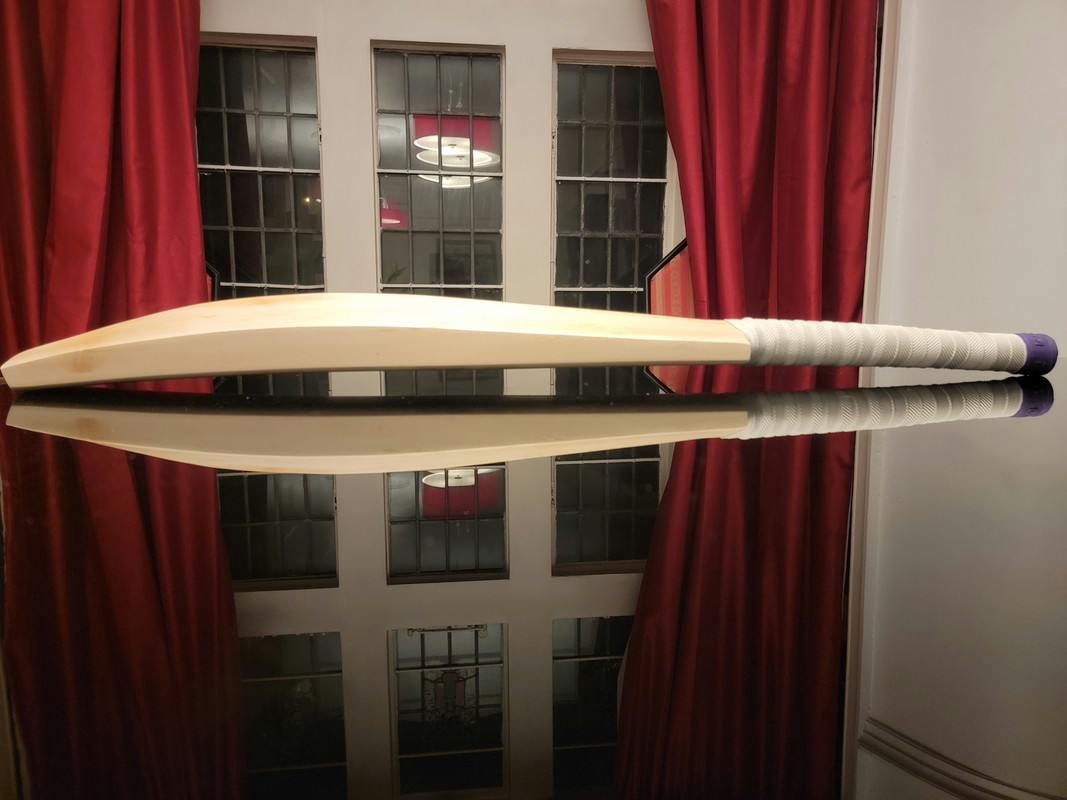

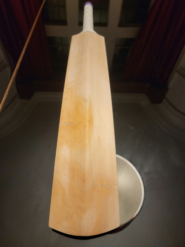

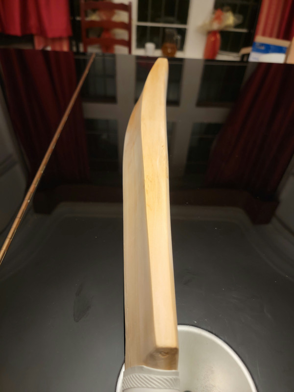

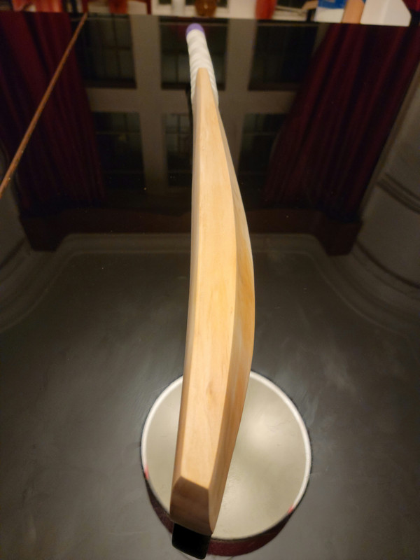

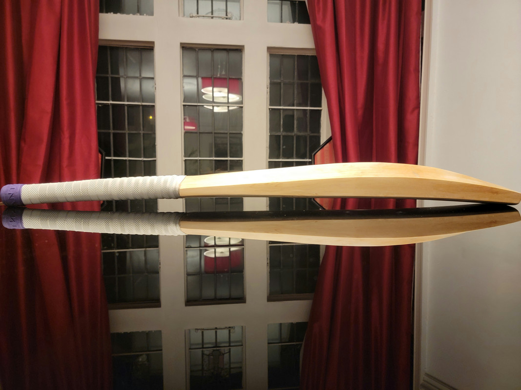

Bat 2:
Edge template - Old BAS Shadow
Spine template - Improvised
Weight with grip and binding - 2lb 10.6oz
Learning aims:
  • I decided to try some concaving with this one and try to learn how to use my round bottomed plane. (For any that haven't dabbled in batmaking yet, hand tools can take a while to get used to, and require small adjustments)
  • I also wanted to have the spine through the toe
  • I had initially set out to try to copy the BAS Shadow, but the spine on the cleft wouldn't quite allow for it, so just improvised and shaped what felt right.
  • I wanted to angle the toe
Where I messed up:
  • Concaving can be quite difficult to get even. I'm sure on this bat, it's not even at all at any given point, but so long as I've attempted to try keep it even, that's okay - it's handmade afterall, and it's my 2nd bat.
  • I can't blend the back shoulder on the RH outside edge too well with what I'm currently doing
  • Finishing isn't great, some knicks with the plane went in deep
Notes I took away:
  • Using a drum sander can be scary, but helps HEAPS in getting it so the back isn't bumpy from where tools get stuck
  • The round bottomed plane was actually a joy to use
  • I see what people mean when they say Butterfly can be hard to work with, or any other blemishes
  • Try not to use the drawknife to do too much, no matter how comfortable you feel with it compared to other tools. It's very easy to make a mistake with it!
  • Spend that extra time going through grits, and try not to skip any grits

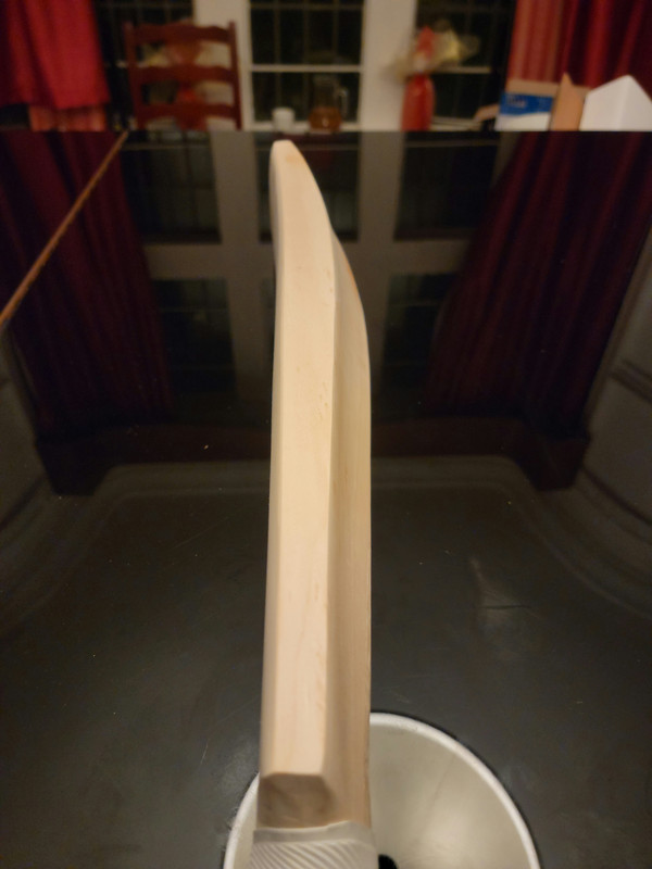

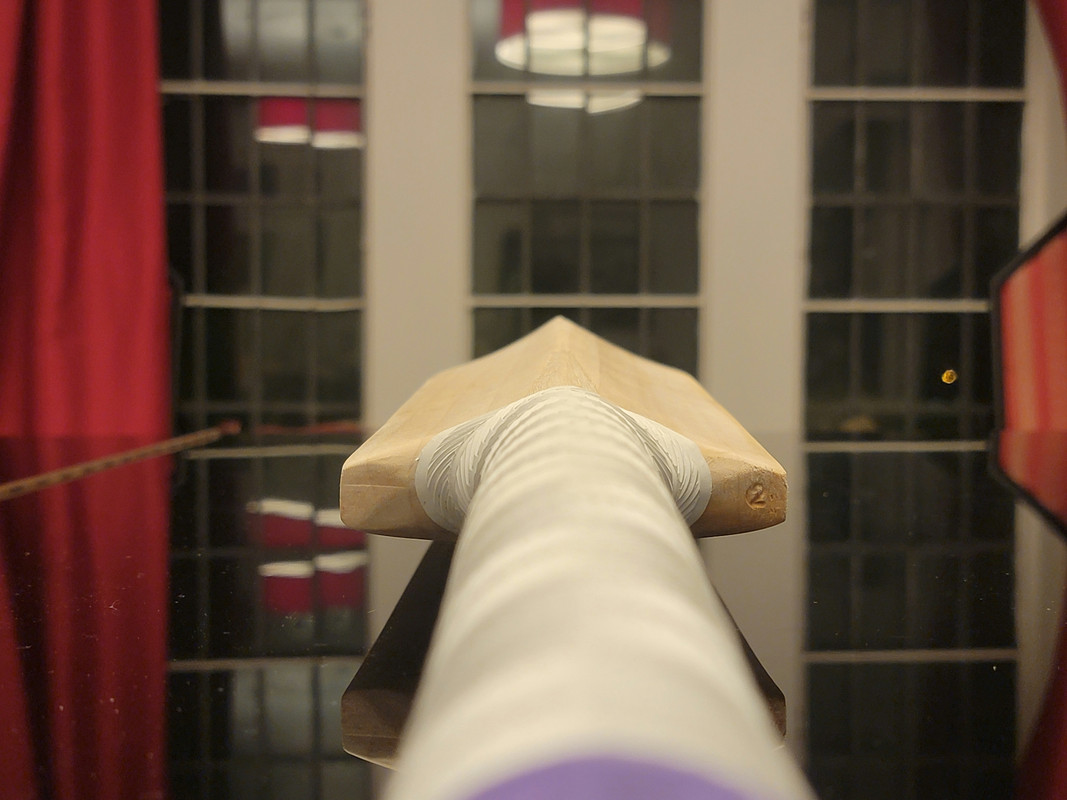

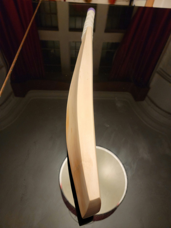

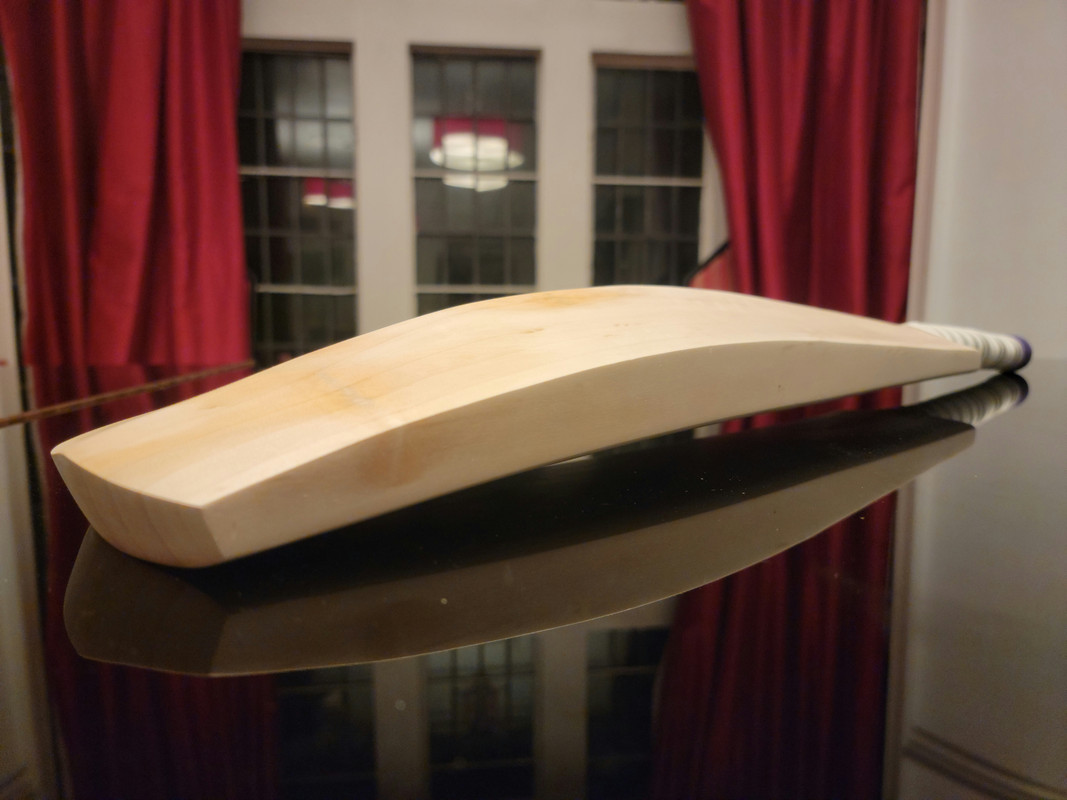

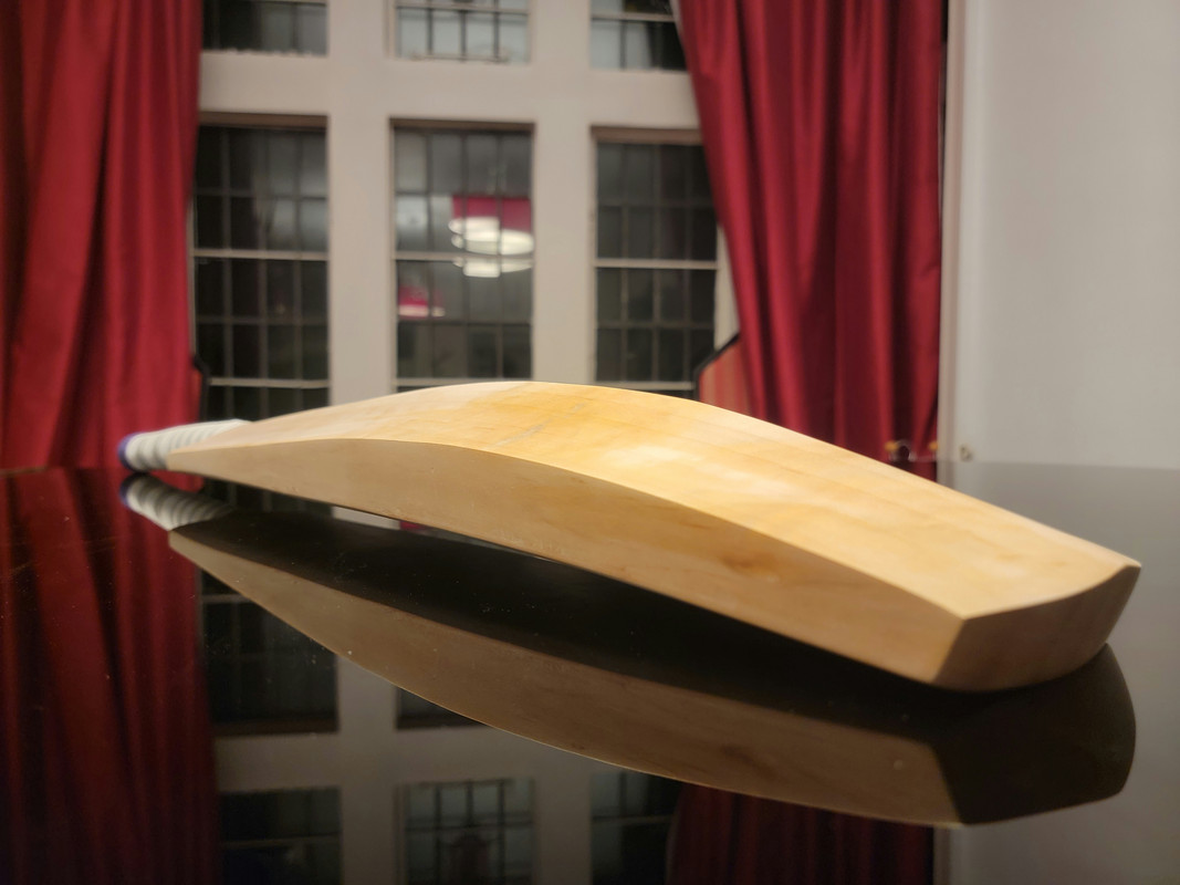

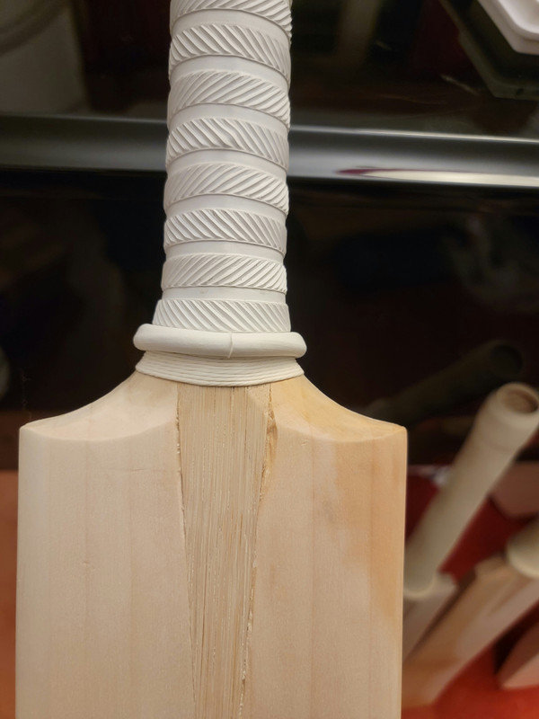

Face, back and profile:
Check to see if I followed my lines somewhat correctly without too many bumps:

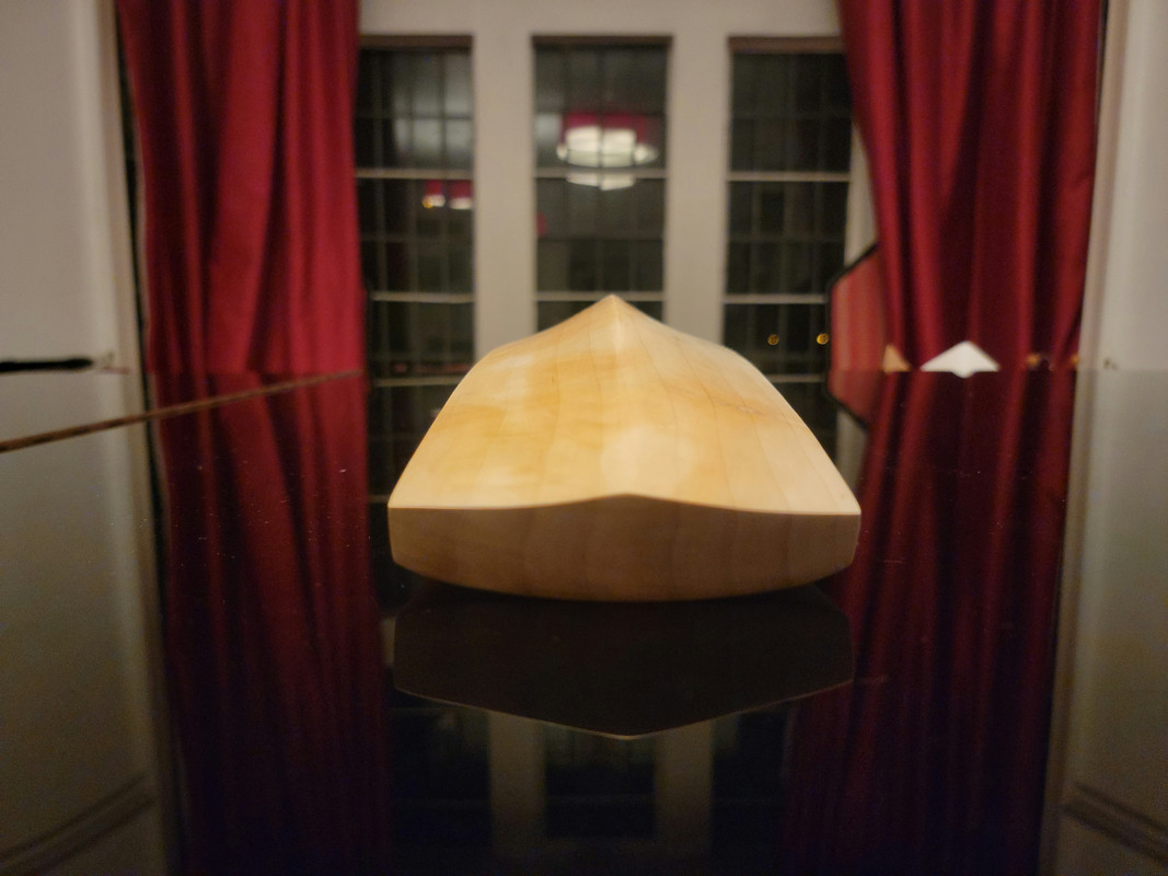

Shoulder Blending:
