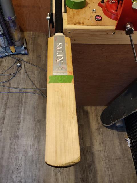

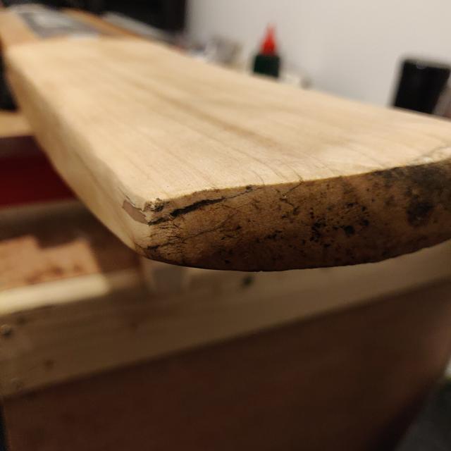

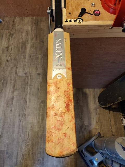

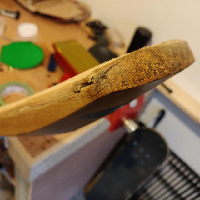

Finished work for Christmas? Time for some refurb. This one is a nice Salix belonging to a clubmate who I usually open the batting with, nothing major but some little bits of feathering and damage round the toe. Face is in remarkably good condition considering how hard he hits the ball!
Before
Scuff removed

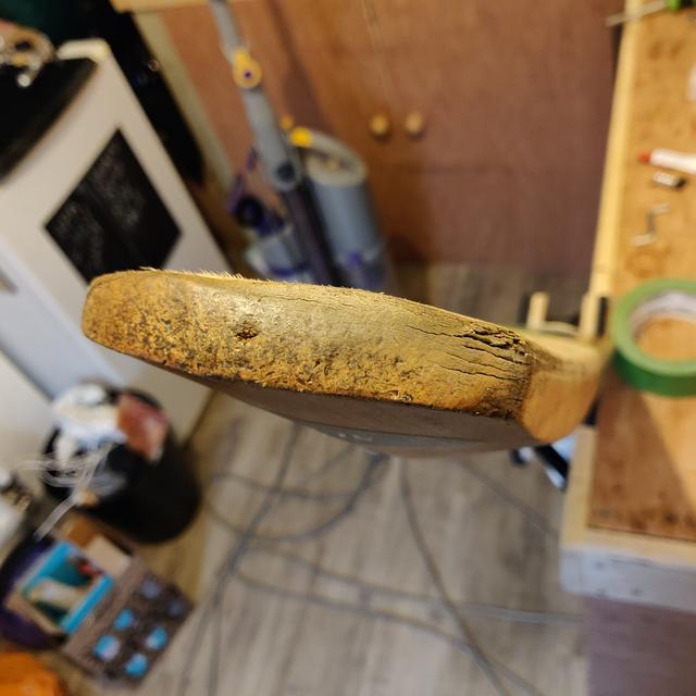

Toe damage

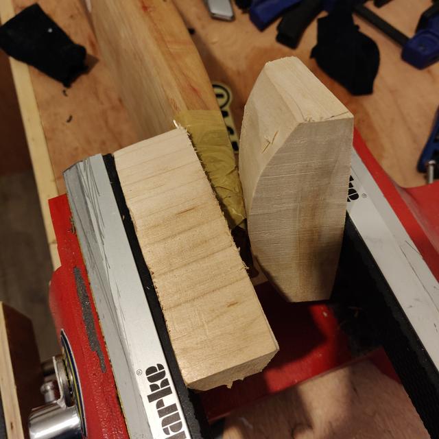

Opened up the feathered side, plenty of glue in there and clamped between some handy offcuts to dry.
[/url]
« Reply #96 on: December 16, 2019, 09:25:09 PM »
Yeah just PVA, open the cracks up as best I can then stuff it down there with a Stanley blade. Best not to overthink it with most repairs in my experience, wood glue does the job. By the time you clamp it up most of the glue gets squeezed out anyway, you only need make sure some gets down there.
Not a fan of square toes but don't really think it makes a huge difference. Go for a flat toe edge with rounded corners on my own bats, best of both worlds.

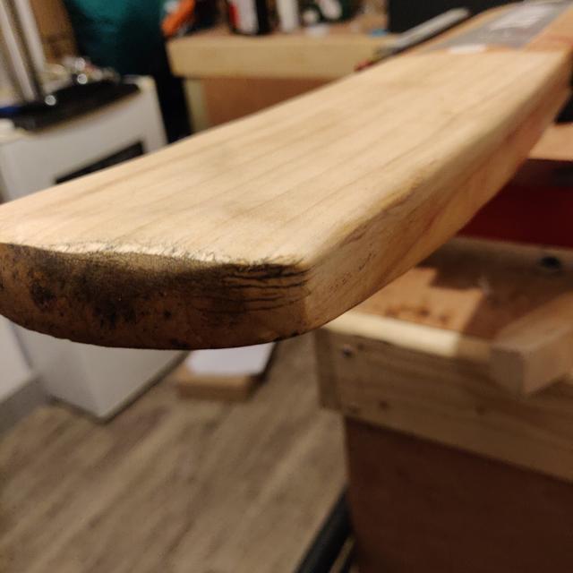

« Reply #97 on: December 19, 2019, 04:40:41 PM »

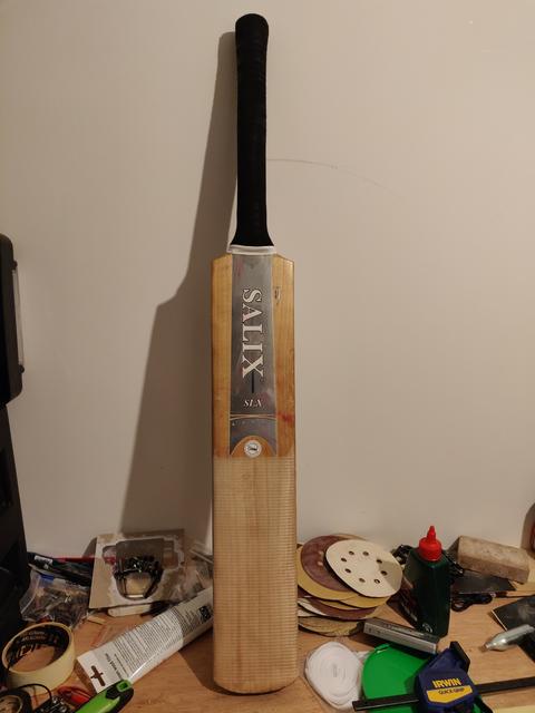

Toe damage glued up nicely, not exactly the biggest job ever but pleasing to do.
Coat of wax and a nice new scuff, grip tidied up, job done.
