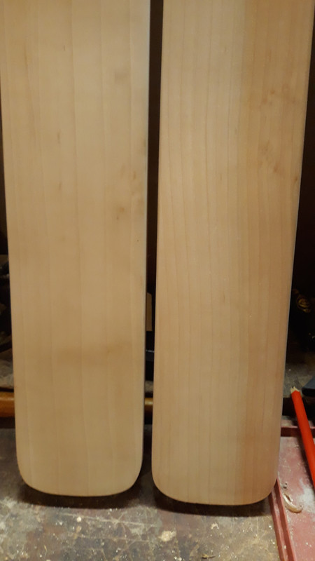

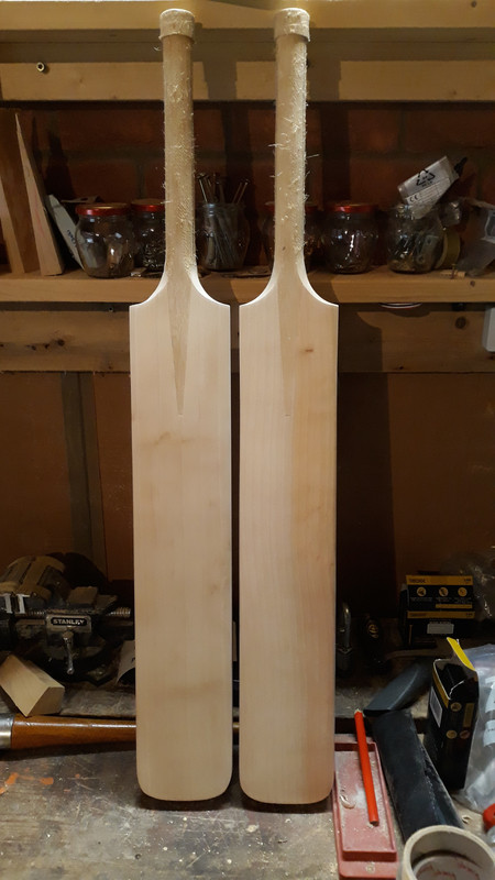

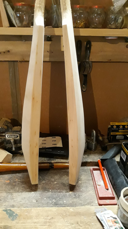

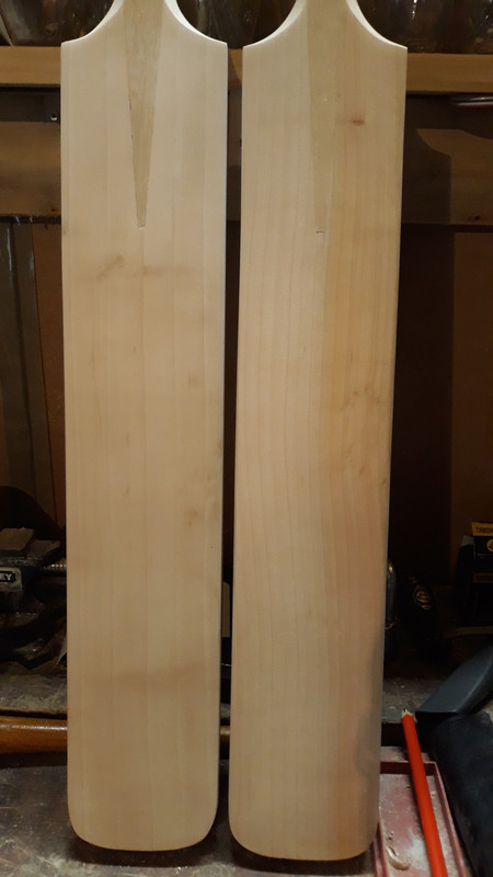

Evening all! And thanks for your patience on this, it really has taken ages - busy year, cricket season, family stuff etc etc. Anyway, you'll be happy to hear that I'm finally getting on with the next stages of this experiment. I had the great pleasure of paying a visit to the home and workshop of forum legend @Northern monkey yesterday afternoon. Excellent stuff, lovely to meet up with Mark and talk bats and batmaking with him. Dude's made his own press! Proper engineering project there, it just shows what you can achieve with a little thought
The Monkey has worked his magic with the 2 clefts - Narrow Grain and Wide Grain - see the photos below, which honestly don't do his talent justice at all. Despite the two clefts being so different, the bats are pretty much identical in profile and feel, and in their naked state weigh in just 46g different. Awesome job, really puts my amateur efforts in perspective. I need to bind the handles and put grips on, then both bats will end up around 2lb 11oz - 2lb 12oz.
Once complete, we can get on with the testing phase. My idea is that the bats be passed around between interested Forum members, so that anyone who wants to have a go with them, can do. If you'd like to be involved just post on this thread and include your location, and we can get the ball rolling through winter nets. You'd need to accept responsibility for using the bats appropriately and then making sure they are posted or delivered carefully to the next tester. Write a review, choose your favourite of the 2 bats, and at the end we can see if Narrow or Wide comes out on top.
