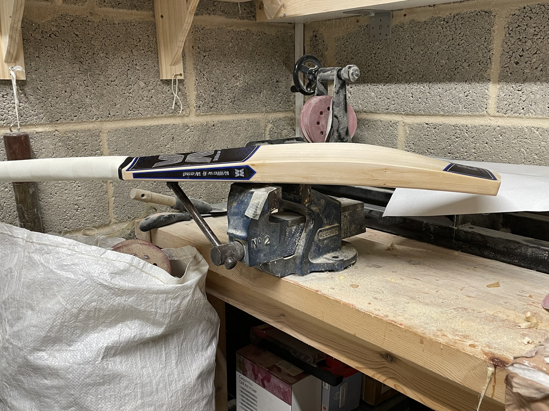

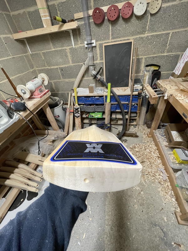

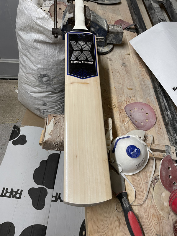

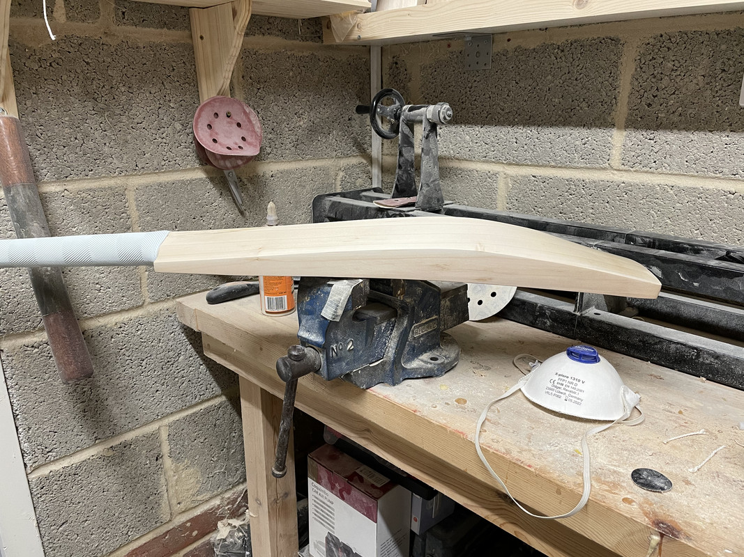

Recent one that I knocked up over the weekend. Grade 3 with a SSH set up and 2lb 8oz with binding and grip. 37mm edge and very full shape with a mid/low middle.

That looks lovely mate, well crafted.

What a nice shape! That's a stunning bat and decent specs for that weight

love that mate, is it making its way to surrey??  ;)
Re: Soulman’s sticks
« Reply #367 on: November 02, 2022, 07:59:58 PM »
Not yet mate lol.
It’s available as I’m trying to build up a small selection of bats ready to go so like some workshop stock basically.

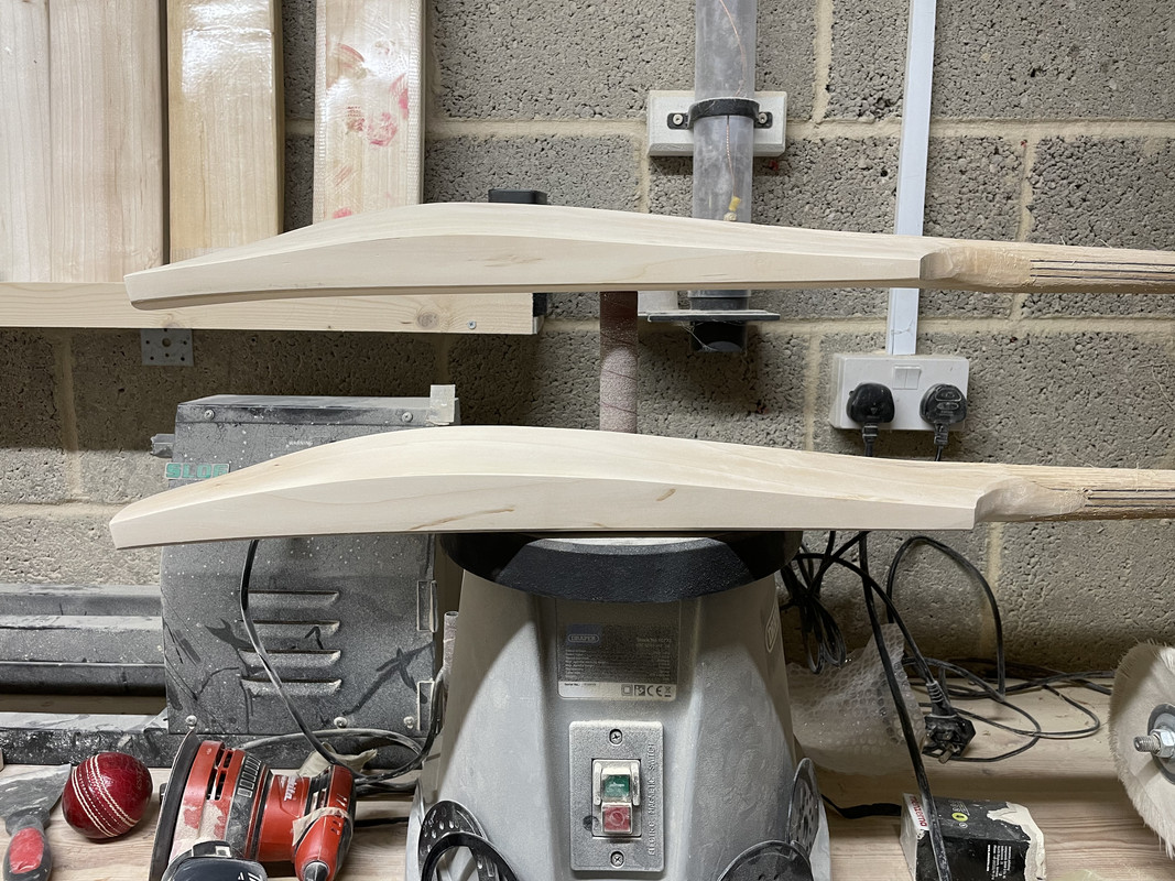

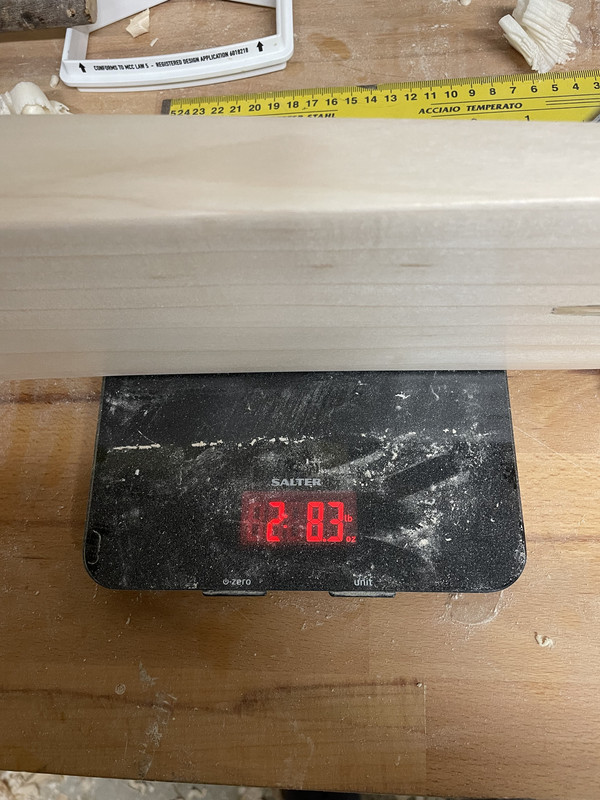

Couple of heavier clefts that iv knocked up as “stock bats” both will 2.12-2.13 when finished. Both in the SL06 profile
Big full profiles and G1 and G3 available if anyone is interested.

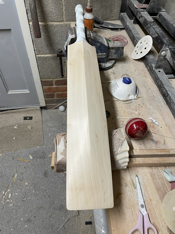

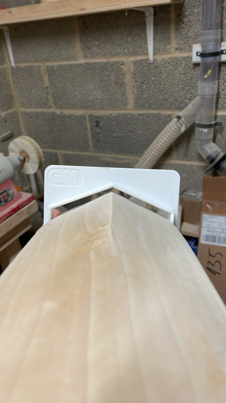

So finished this one up last night, sub grade due to the large knot on the face and also there was another on the rear by the splice. Finished weight 2lb 8.8oz, 33mm edge, 17mm toe at edge and 27mm toe in the centre. Shame as would have been a G1 cleft otherwise.
SL06 profile, semi oval handle

Perfect example of a cleft that a big brand would just chuck a sticker over the blemish and call it G1 anyway - lovely shape mate, great work.
« Reply #373 on: November 23, 2022, 09:14:59 AM »
I’d agree with Adam,,,that’s a lovely piece of willow
Shape looks perfect tbh,,,cracking job that Chris
« Reply #374 on: November 23, 2022, 09:46:55 AM »
Agree with the above, lovely stuff. I see some ridiculous Grading out there. G2s which wouldn't pass as G3s and its not great for the customer. I appreciate its subjective, but sometimes its just taking the *#@&, so fair play to you mate
