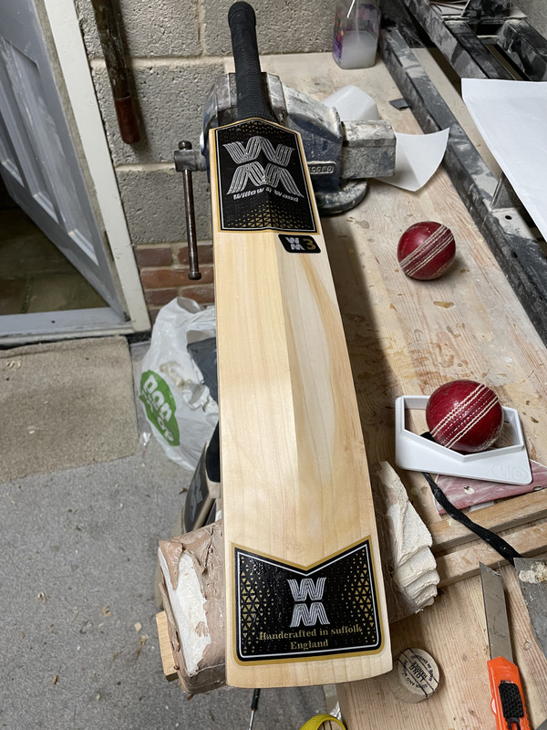

Perfect example of a cleft that a big brand would just chuck a sticker over the blemish and call it G1 anyway - lovely shape mate, great work.
Thank you mate and means a lot to have kind comments from a brand who’s business model and rise iv admired for a while

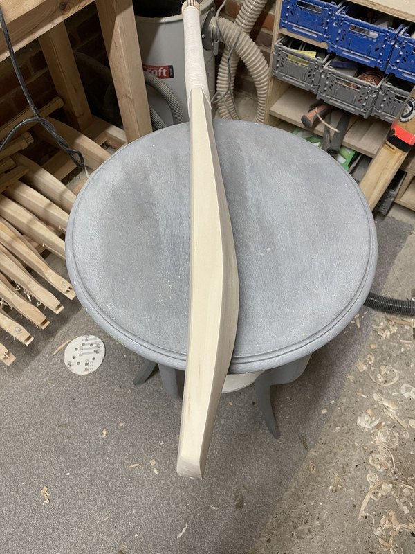

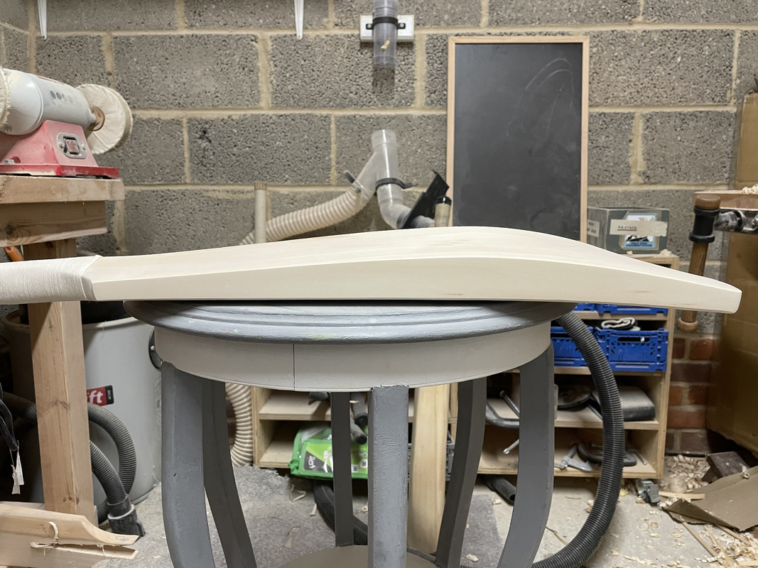

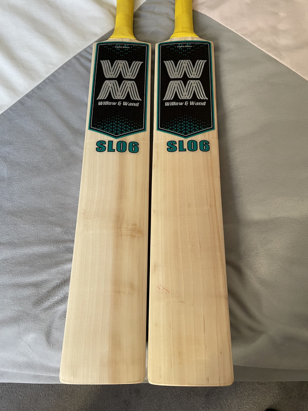

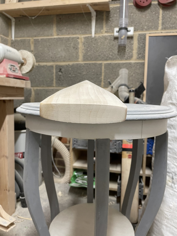

Happy new year to everyone. Just a couple of bats that have been keeping me busy over the festive period.
Firstly is this copy to a degree of a 1980’s Newbery. This cleft had some damage to back and edge so required a small edge profile so I created a high spine small edge profile. Grade 2 and finished at 2lb 9oz with a very thick oval handle and huge toe 31mm at centre of toe, edge was 21mm at peak and 17mm at shoulder and toe edge.
Secondly was this grade 3 modern “Pro” shape very similar to the SL06 I make but with a mid/low middle really pleased with how this one came out as was a bit of a pig to work for some reason, shape really flows well and will be around 2.10.5 - 2.11 when finished ( it’s currently available at present time)

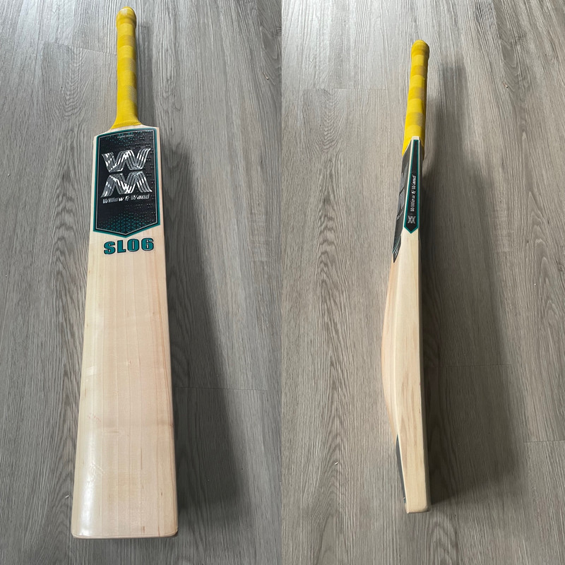

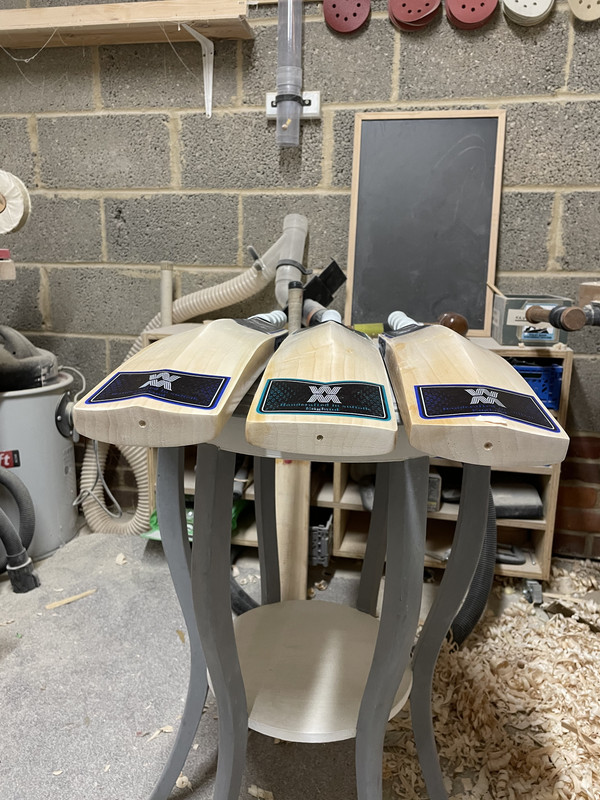

Evening all. These are a selection that I’m making to exhibit at Suffolk Crickets first expo in late January. These are a selection of my AM18 and SL06 profiles.
This is a super light SL06 currently 2lb 4oz, 32mm edges. Grade 1. Full profile working on the basis this year that I’d rather offer fully shapes than edge size as I personally fell that just offers a better all round bat on the stock shapes and I’ll leave the EH21 as the concaved profile.

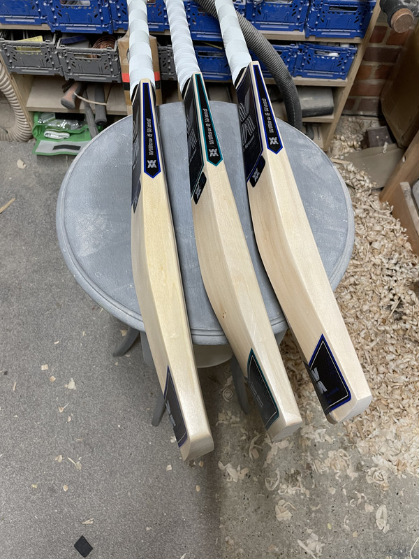

First batch of 2023 orders completed.
2 x EH21 profiles both weighing 2lb 9oz. One Grade 1 and the other Grade 2
1 x SL06 custom weighing 2lb 7.8oz, Grade 1

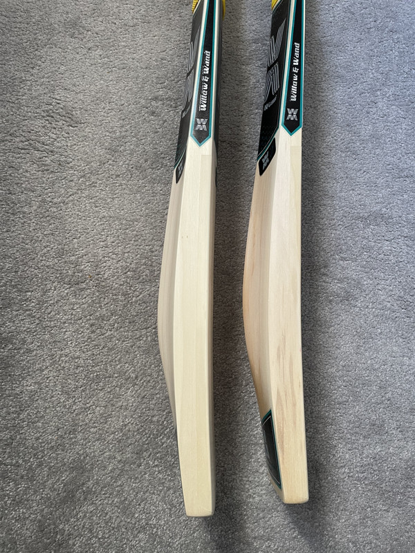

« Reply #381 on: January 31, 2023, 10:17:45 AM »

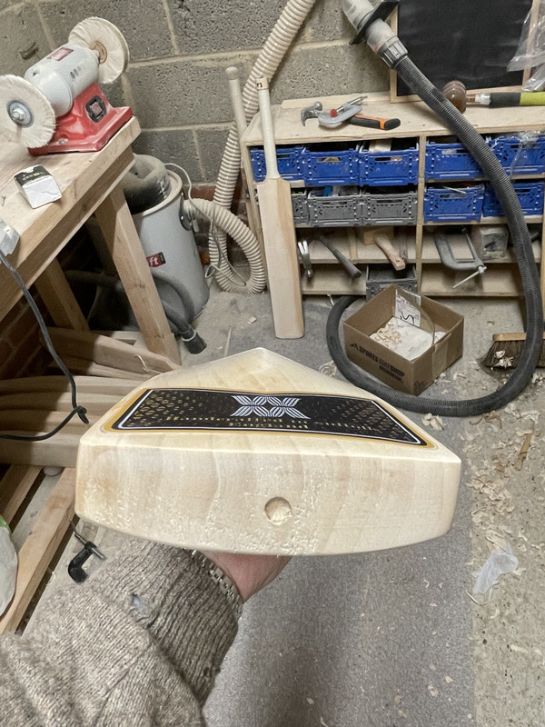

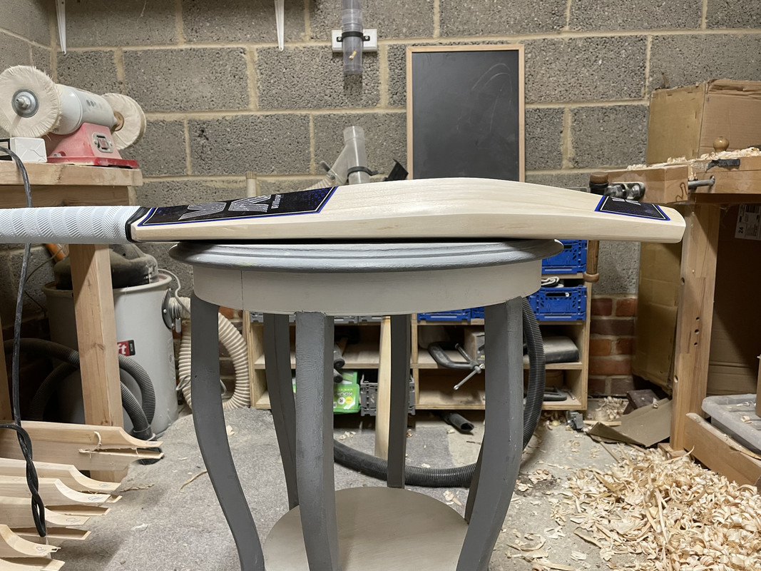

Recently attended my county’s first cricket expo, was great to be alongside Gray Nicolls, NV play and lots of companies with so much experience and insight into the game. Had a great conversation around this new softs regulations but any way.
So I was able to display my full range and here are a couple from the day. Both G2 and both 2.10
Re: Soulman’s sticks
« Reply #382 on: January 31, 2023, 12:30:43 PM »
Really like that slightly fuller shape, lovely bit of work mate.

« Reply #385 on: January 31, 2023, 05:37:54 PM »
Cheers mate, fuller shapes over edge size these days. Need to invest in better camera or upgrade the phone but really pleased with how these are coming out shape wise now since some investment in some Windsor tools, better polisher and new sander as well.
« Reply #386 on: January 31, 2023, 06:25:22 PM »
Big fan of that, as much as I love a big edge there's something so much more aesthetically pleasing about a full shape. Purely psychological but the confidence of a full shape does it for me way more than massive edges too.

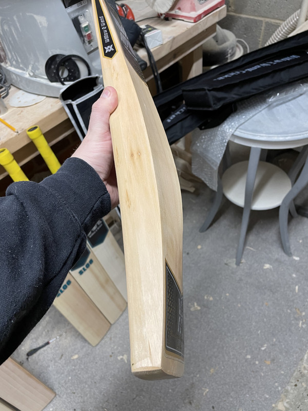

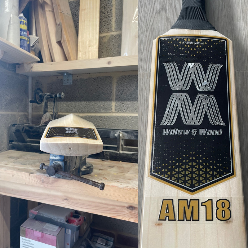

So been busy finally getting around to creating a website which will be launched soon so I had to make a few bats to show the range.
SL06 modern “pro” shape
AM18 - 1/2inch shorter blade full profile
EH21 - now currently iv got a few partmades that have a flat face press so I’m using these for this model to give a slightly bigger edge to a more traditional profiles bat. We’ll see what customers feedback is like on these as the feedback on the clefts iv used since creating WW has been amazing.

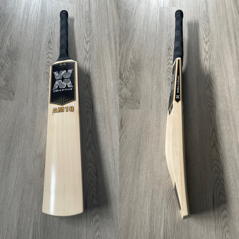

« Reply #388 on: February 23, 2023, 09:22:15 AM »

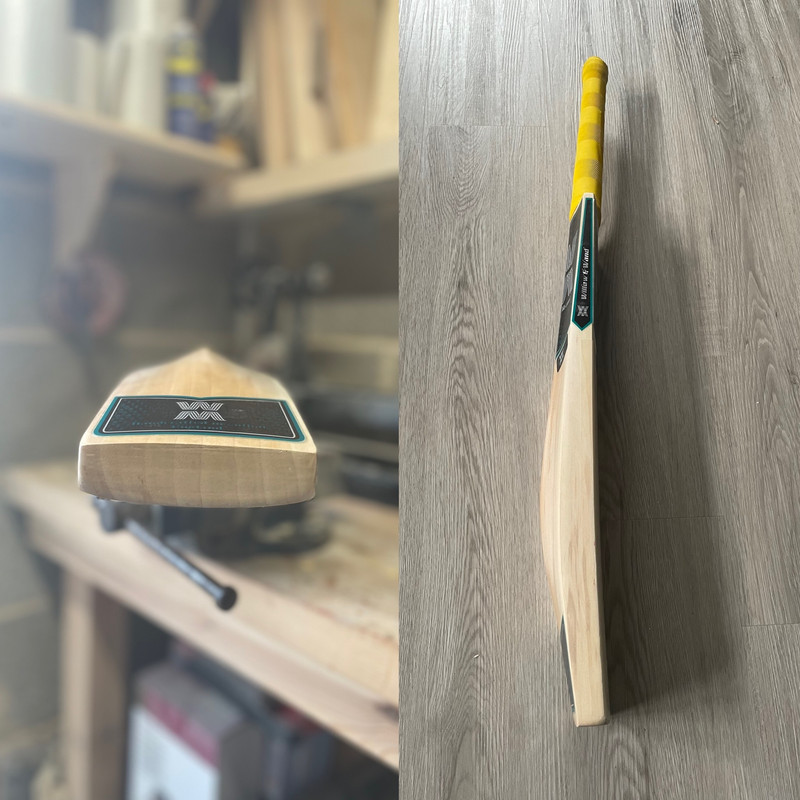

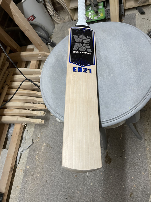

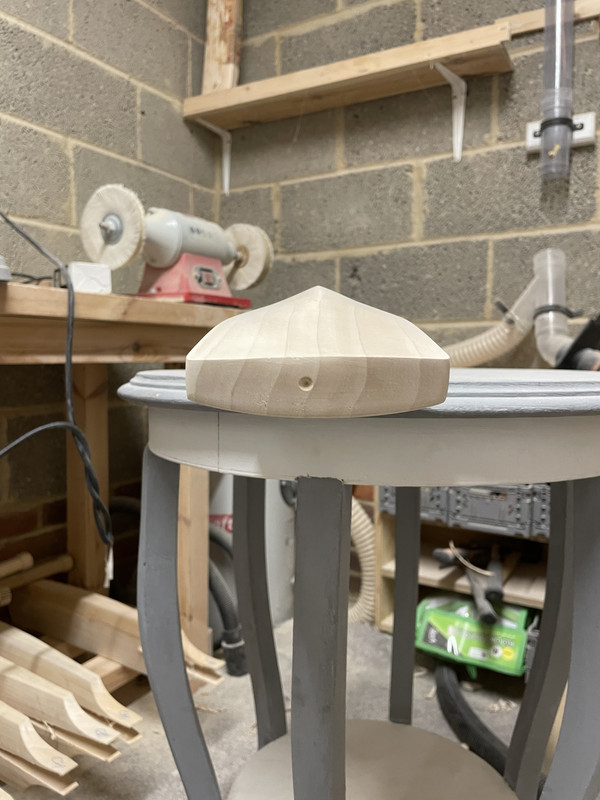

Couple of bats made up this week.

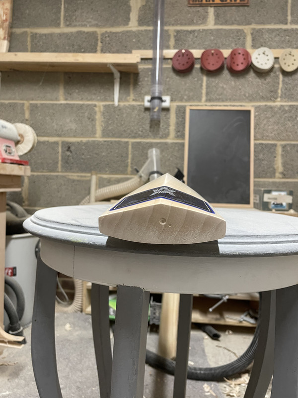

First up is this outrageous Butterly. Not sure iv ever seen a nicer one especially with no blemishes on the face just on the rear and is actually covered by the toe sticker. This finished 2lb 9oz with 34mm edge 20mm toe at the edge and 26mm in the centre in the SL06 profile but the customer asked for the traditional round toe shape from the AM18 instead of the square/flat toe as standard on this shape.
Next up was this AM18 grade 2. Finished at 2lb 14.2 and his current match bat is 2.14.3 so very happy how I managed to basically get it spot on weight wise. This is 1/2 inch shorter blade longer handle set up and has so far this year been the more popular shape. Seems the outside forum world is catching onto the benefits of slightly shorter blades. This bat has 37mm edge, 23mm toe at edge and 29mm at centre of toe, customer specified a thick toe.

« Reply #389 on: February 23, 2023, 10:48:42 AM »
Oh my Chris - some absolute stunners, I love how the shapes have evolved.
Clearly lots of thought has gone into what us batters like best.
I can’t seem to find your website tho mate… have you got a link pls?
