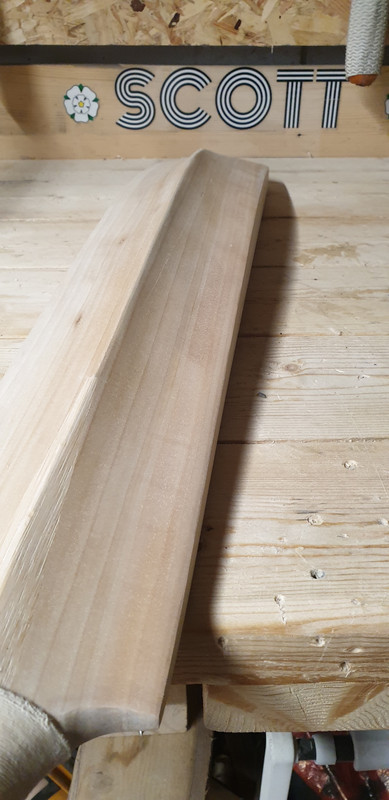

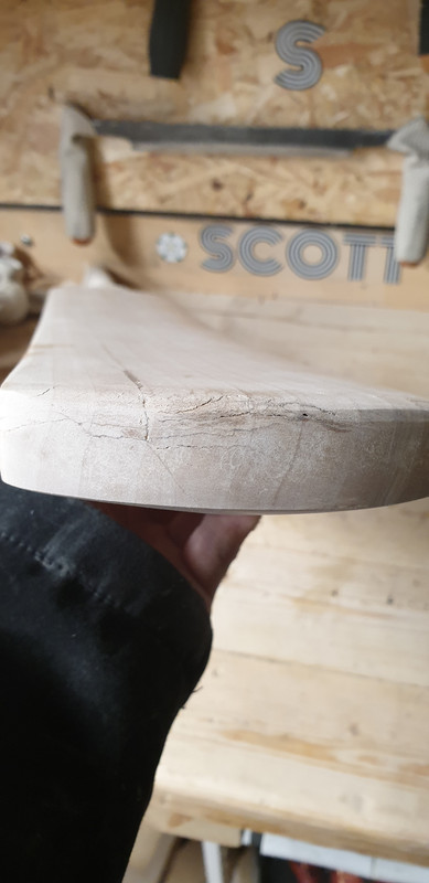

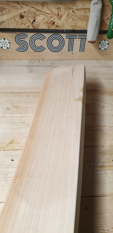

« Reply #128 on: February 25, 2020, 10:33:26 PM »
« Reply #129 on: February 25, 2020, 10:36:23 PM »
https://www.instagram.com/p/B8_ykQPB-YH/?igshid=1jg0yhctosh3c
Video showing the ping following the repair, seems to go ok 😁
bigblue365
  • Posts: 172
« Reply #130 on: February 26, 2020, 04:19:57 PM »
Very nice refurb. Can it be used in nets without breaking again?
« Reply #131 on: February 26, 2020, 05:31:24 PM »
I hope so mate! You never know how long it'll last but its solid enough now. As always I advised of this before doing the repair and the guy was happy to give it a go.

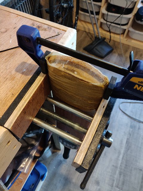

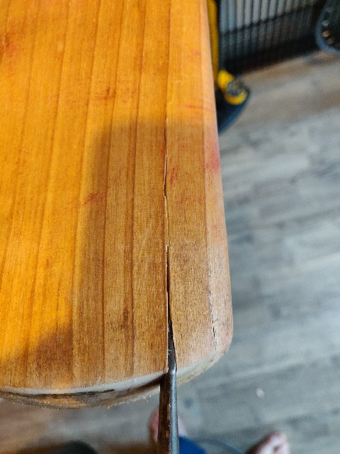

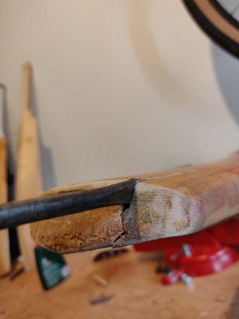

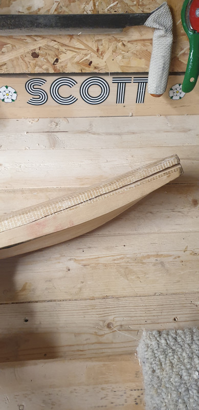

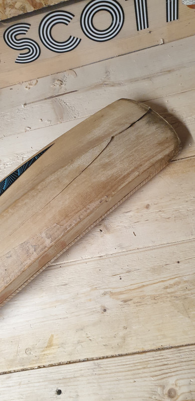

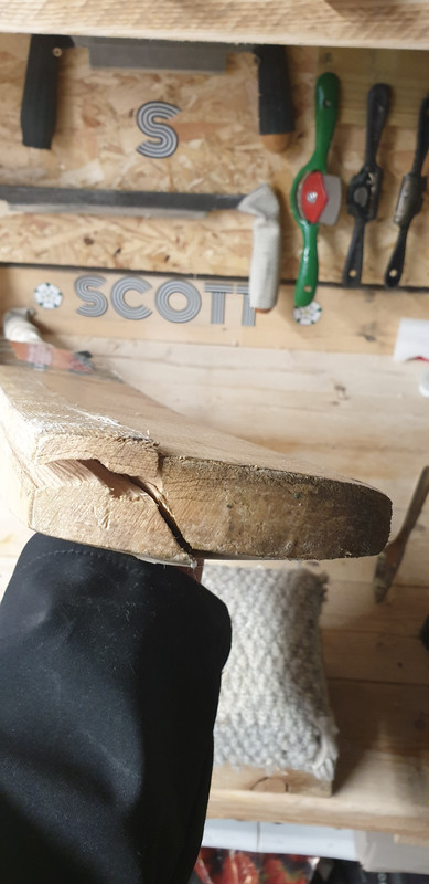

Teammate of mine did a good job on the toe of his M&H last week, cracked right through and up several inches front and back. Annoying on as the crack is still pretty well attached, so had to go through the never enjoyable step of ramming a screwdriver in there to open it up. Got it full of thinned down pva pretty successfully and bound it up tight. Will probably dowel it when this is dry, don't think the repair will last long otherwise.

^ owww...
